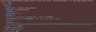

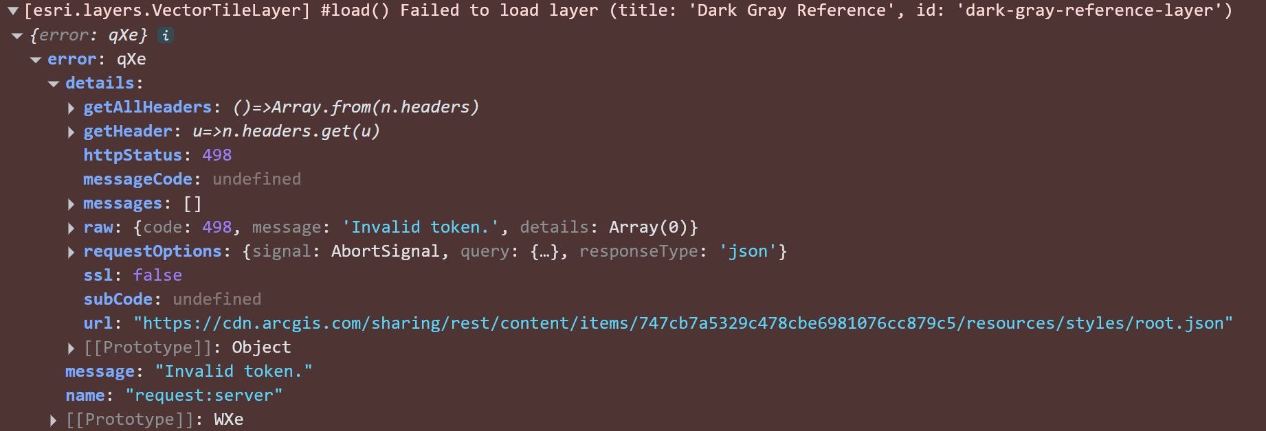

In the hosted site, it's not working. I've verified via console log that the proper key is being used, but the basemaps aren't loading.
