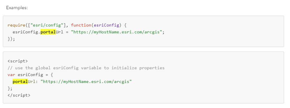

Set the portalUrl of the esriConfig object you import, you're creating a new object and overwriting the default one.
https://developers.arcgis.com/javascript/latest/api-reference/esri-config.html#portalUrl
esriConfig.portalUrl = "https://myHostName.esri.com/arcgis"

if you are going to use the esriConfig global object, you need to put it in a script tag above the one that imports the map modules.
Or you can import the esriConfig like you did and set the portalUrl on it
You can't do both in the same script tag
