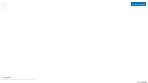

In the following test app, I am creating a feature collection and set the definitionExpression. Then from update attributes button, I change the attributes of two features. Layer is updated correctly show the features that only meet the definitionExpression. https://codepen.io/U_B_U/pen/wvpObbJ?editors=100
