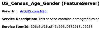

As you can see in the below living atlas layer, there are multiple layers inside (state,county,tract etc..)
But when I add this link, it will display only the first layer.(State). Then, when I zoom in the map, that layer disappears.
I want to display all the 4 layers of that feature service.(state,county, tract, blockgroups)
How do I achieve this?

You have two options
Layer.fromArcGISServerUrl
https://developers.arcgis.com/javascript/latest/api-reference/esri-layers-Layer.html#fromArcGISServe...
Or using Layer.fromPortalItem
https://developers.arcgis.com/javascript/latest/api-reference/esri-layers-Layer.html#fromPortalItem
The root on the service will give you the itemId
