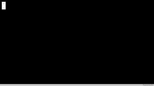

I want to assign a labelexpressioninfo to a labelclass for a featurelayer that may contains single apostrophes. However, these labels appear to interfere with the arcade expression construction. How can I get the label to appear? Escaping the character does not help either.
codepen demonstration issue with label "Bob's":
https://codepen.io/coxfsi/pen/KKrGNbj?editors=1000

If working with a literal, you must "double escape" the apostrophe:
const name = "Bob\\'s";
//etc
labelExpressionInfo: {expression: `"${name}"`}
Otherwise, you'll need to do the escaping in the expression itself:
const name = "Bob's";
//etc
labelExpressionInfo: {expression: `Replace("${name}", "'", "\'")`}
