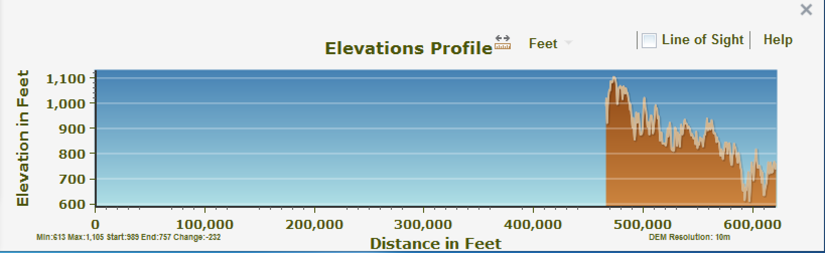

I am using the Javascript Elevation Profile widget for the WebAppbuilder
and have updated the 'this.elevationData' values to start at a number greater than 0.
i.e my collection of measurements would have values like 500,600,700 instead of 0,100,200.
The Chart displays my elevation data at correct measurements but still includes the 0-500 part of the chart(and labels) that has no data.
So my question is how does one control the Xaxis labels and make the chart 'fit' my data, not assume I am starting at 0?
If you see the attachment the data that is showing is exactly what I want, I just want the labels and the data to start at around the 460,000 mark. Removing 0-460,000 from chart and x-axis completely...
Thanks..just looking for a nudge in right direction.Screen Shot 2015-08-13 at 9.07.11 AM.png
AaronFischer
I figured out the issue was with the adding of the losmarkers series.
I removed the line that added that series and it now works as desired. see attachmentScreen Shot 2015-08-13 at 10.20.10 AM.png
