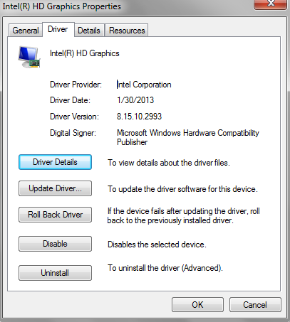

Is this what you're looking for? Yes, I have a very old OS, but it weirdly works when using the Google Chrome browser, but that's not my default or the one I like to use:
It's also strange that I can use it when I open it in Arcgis and their classic viewer. This is looking more like it'd be an issue with the state website and the Firefox browser, huh?

Also would need to know the CPU model & discrete GPU model (if there is one). Safari, Chrome, and Firefox all have their own APIs that go from WebGL -> GPU driver instructions, so it's often the case that you'll see different behavior or different platforms due to either (1) bugs in the browser or (2) browser-specific workarounds for bugs in graphics drivers.
MapViewer Classic does not always use WebGL, and when it does, it's a very early version of the 4x engine. So I would also expect to see differences there when it comes to WebGL-related browser/driver-specific issues.
