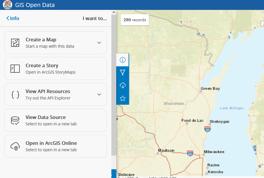

Having the exact same problem:
"A problem was detected with your graphics driver. Your driver does not appear to honor sampler precision specifiers, which may result in rendering issues due to numerical instability. We recommend ensuring that your drivers have been updated to the latest version. Applying lowp sampler workaround. [0.0.0.0]"
I'm running the latest version of FireFox, but this has been happening two or three versions back, too. The thing is that on Chrome, I don't have these problems. Here is the site I'm using:
https://gis-michigan.opendata.arcgis.com/datasets/cities-1/explore?location=43.941754%2C-85.411212%2...
I'm unable to select any feature on the map. I have a really old OS (Windows 7), but it's saying that the graphic driver isn't updated, and it very much is. Any help?

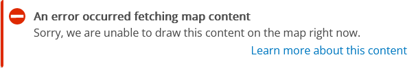

DamonDamon

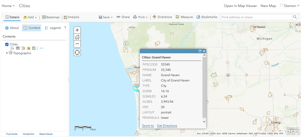

Unfortunately, none of those worked. In fact, when I disabled webgl.disabled, I got this error when trying to pull up the arcgis map on that website: Screenshot 2022-07-11 at 20-58-45 GIS Open Data.pngScreenshot 2022-07-11 at 20-58-45 GIS Open Data.png
Interestingly, when I go to "Open in ArcGIS Online" and select "Open in Map Viewer" and then "Open in Classic Viewer" I can select the features:Screenshot 2022-07-11 at 21-04-01 GIS Open Data.pngScreenshot 2022-07-11 at 21-04-01 GIS Open Data.png
