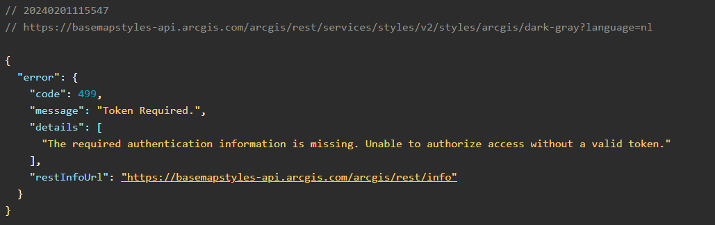

But recently I tried to add basemaps and the requests were ending up with 401:
const webMap = new WebMap({
        basemap: {
          style: {
            language: 'nl',
            serviceUrl: `https://basemapstyles-api.arcgis.com/arcgis/rest/services/styles/v2/styles`

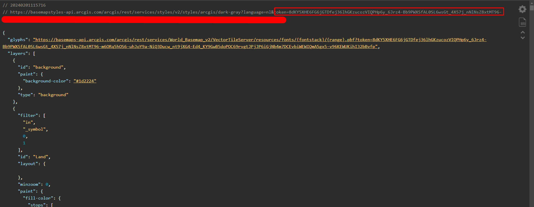

If I add that token manually to the URL there are no issues
Is there a way to specify a token when creating a basemap instance? Or make it use IdentityManager anyhow?
