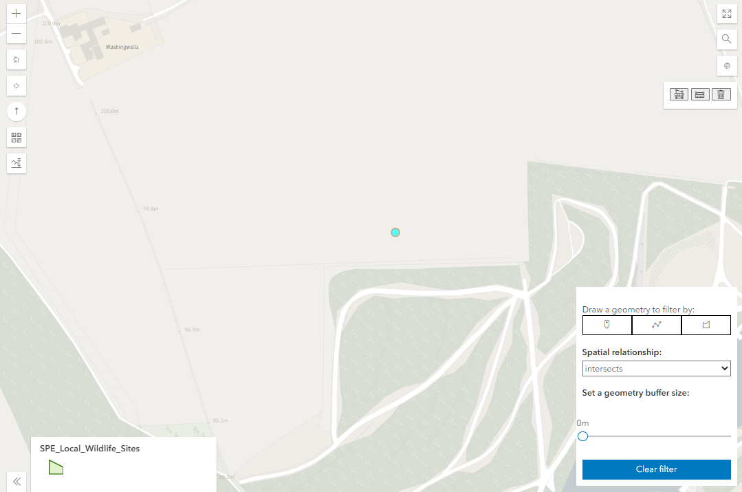

For example, even though this point has no features intersecting with it (and thus filtered), a layer shows up in the legend due to being present in the mapview:
