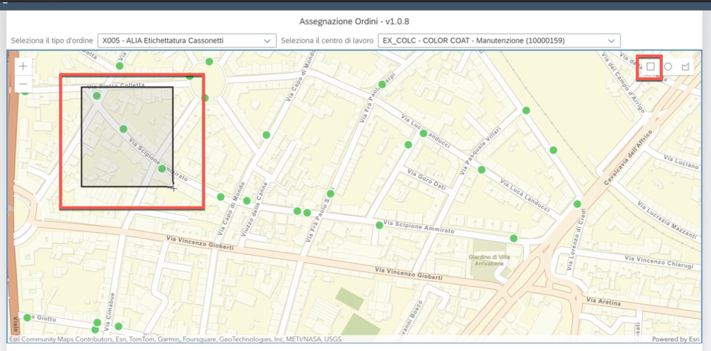

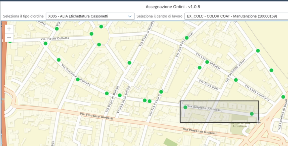

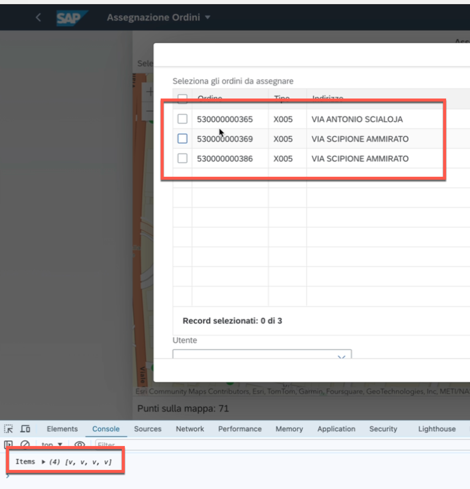

Look at this case. First we select 3 points
and all seems fine:

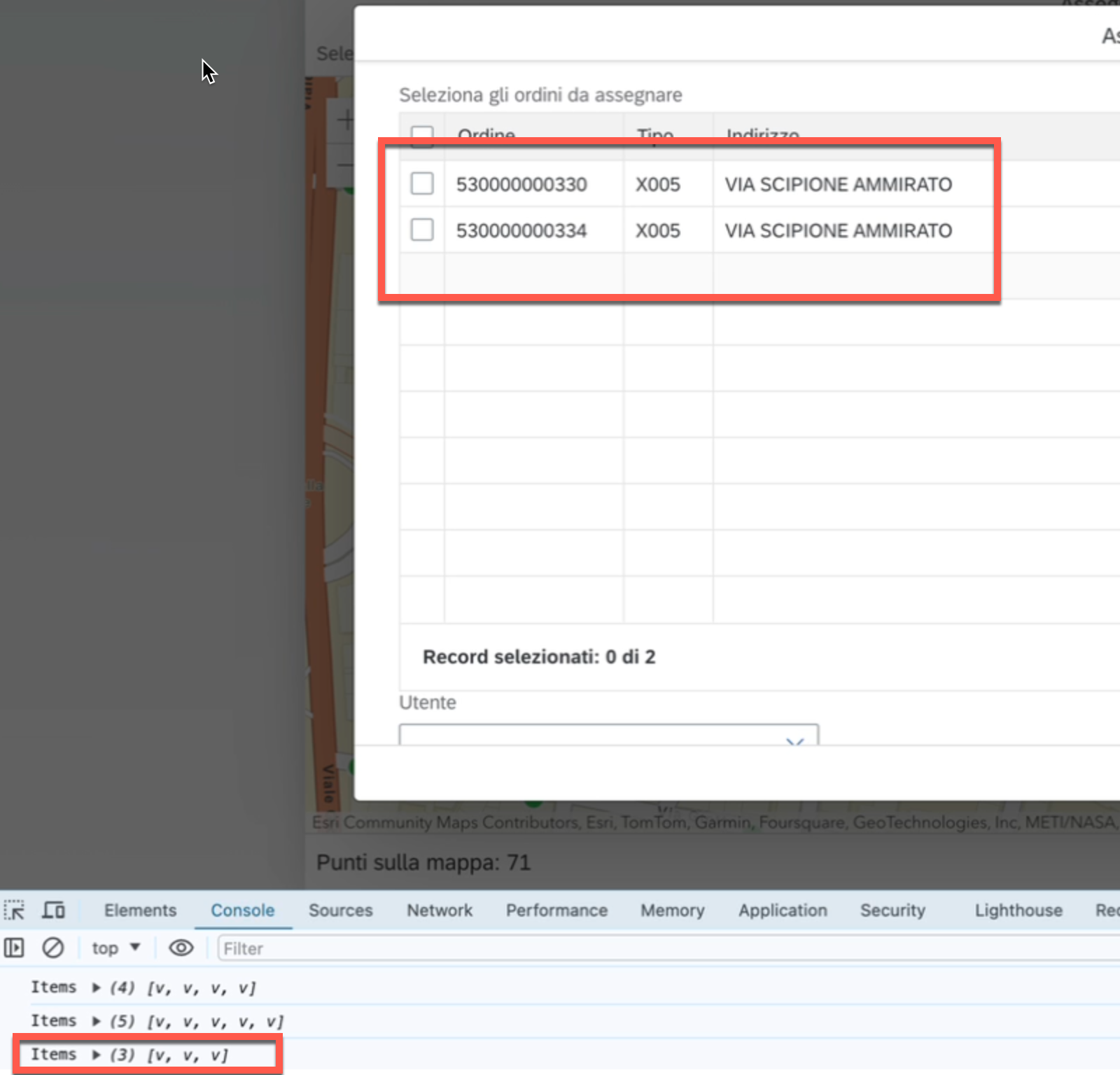

Three points are selected correctly. In the console you see 4 because one is always junk and not used.

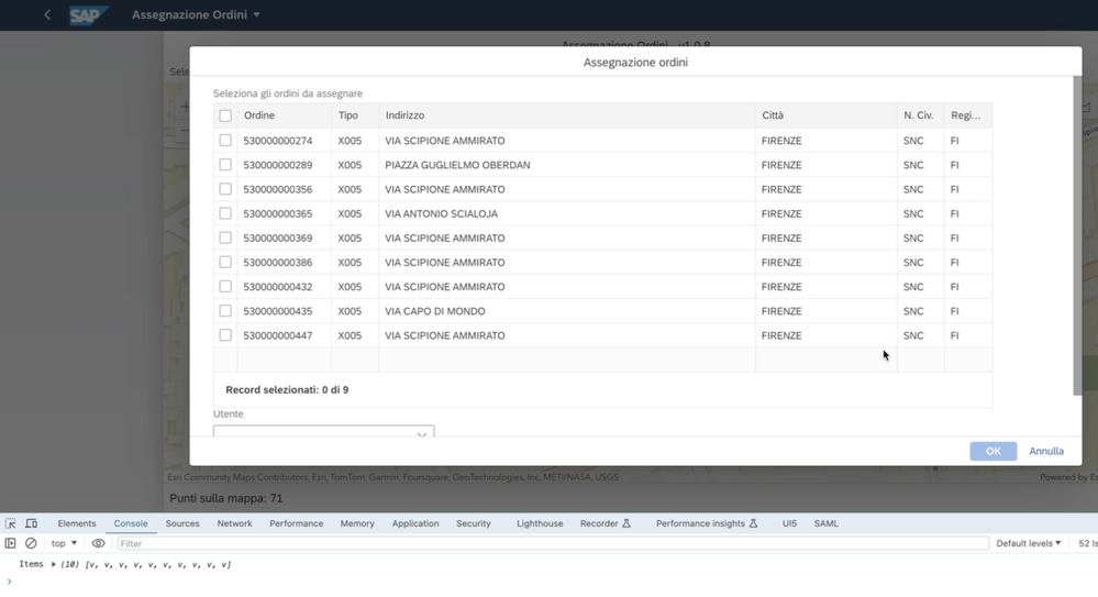

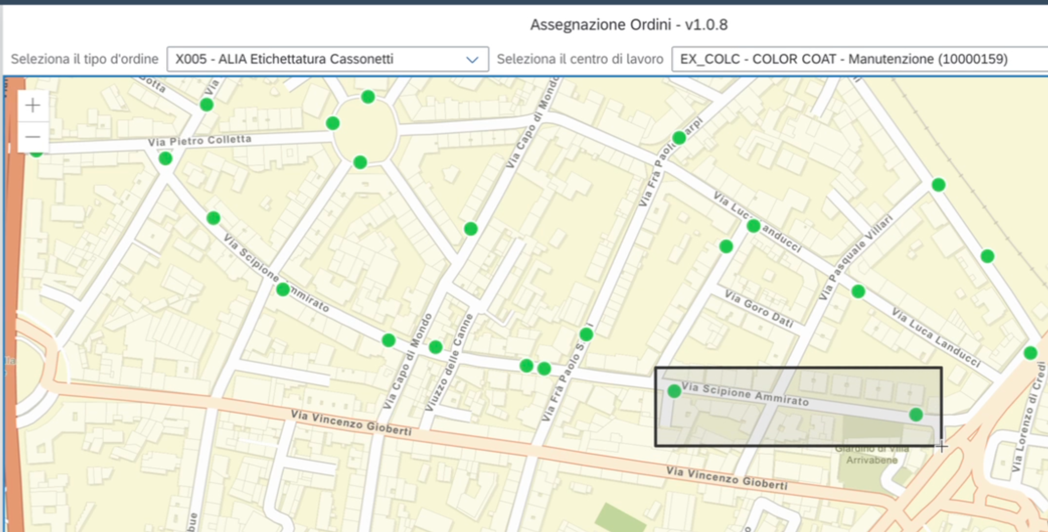

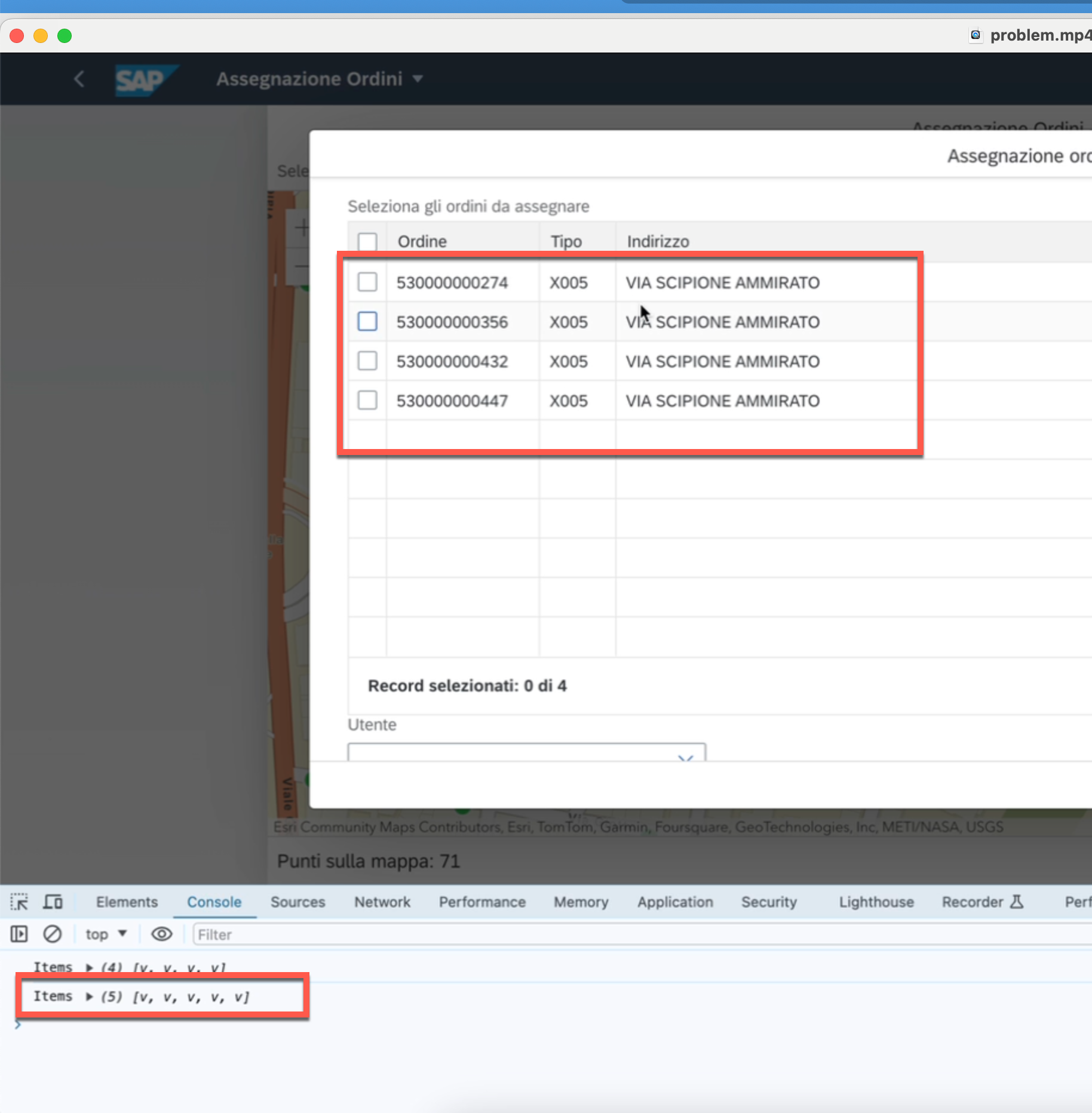

Then we take 4 other points on the same street:
Even in this case the result is correct:
(One point is always junk and not used)

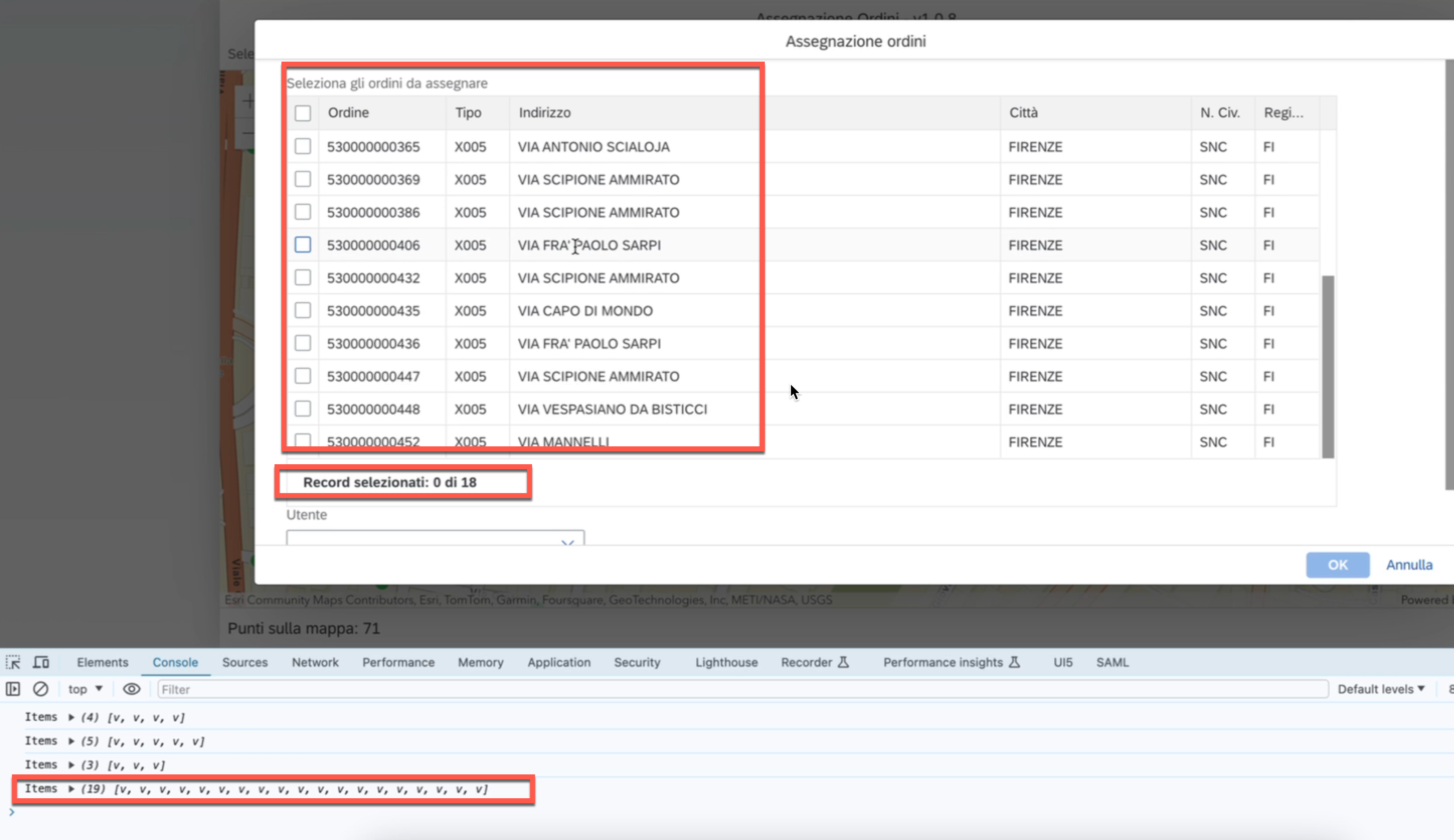

Finally, we select the remaining 2 points
and in this case too, all is correct.
So, in total, I've selected 9 points (consider that for each selection one is always dummy)

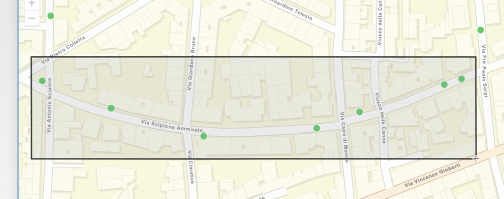

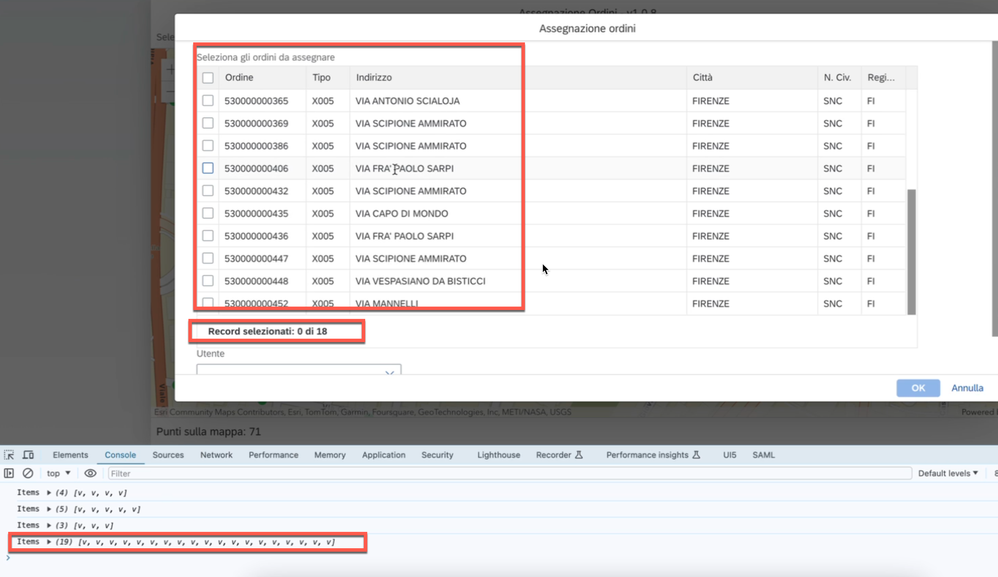

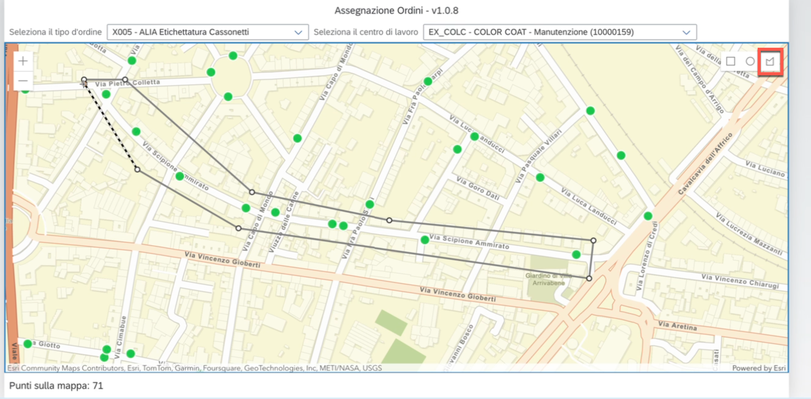

But, if select all the points together using a segmented line
it brings me more than the ones I selected
How can I fix this strange behavior? Why it's not so accurate when I extract the selected points?

Others are far more proficient in 4.x than I am but could it be that you're using event.graphic.geometry.extent which might be treated as a bounding box for the graphic rather than it's actual shape?
In the selections that work, you'll notice that there aren't other points located within the square of your selection but if you look at your polygon selection, and use the xmin,ymin.xmax,ymax rectangle of the polygon, you'll see that many other points would be selected based on that rectangular shape.

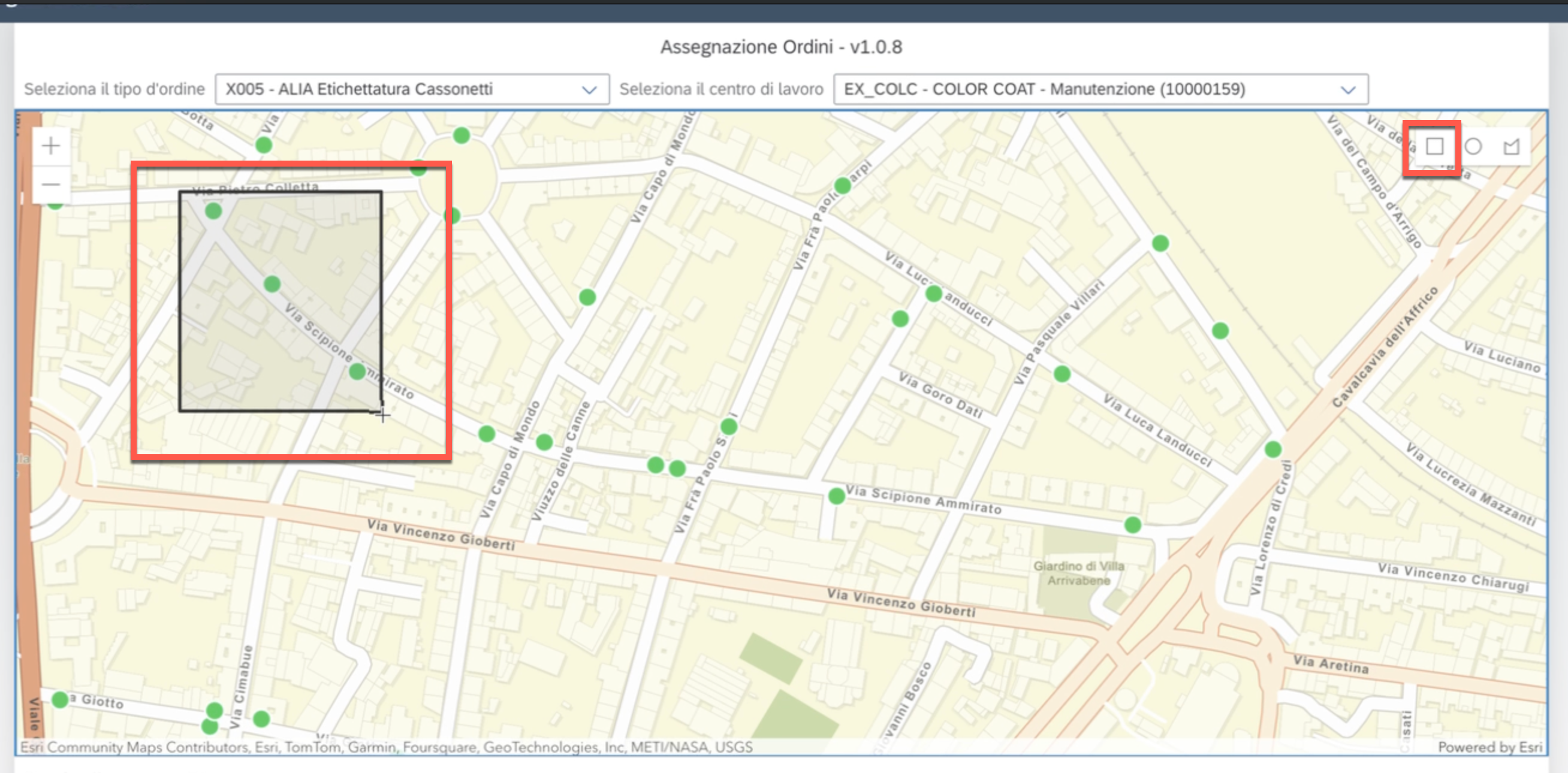

However, I'm not sure this is the real cause of the problem. Indeed, if I rotate a little bit the map and use only the rectangular selection, I have the same issue. Look at this new example.

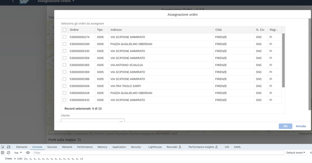

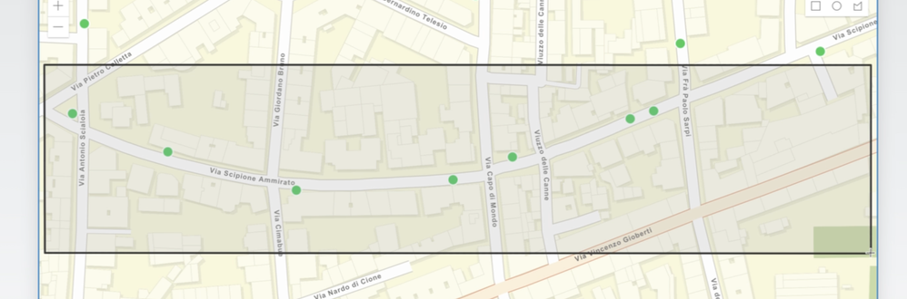

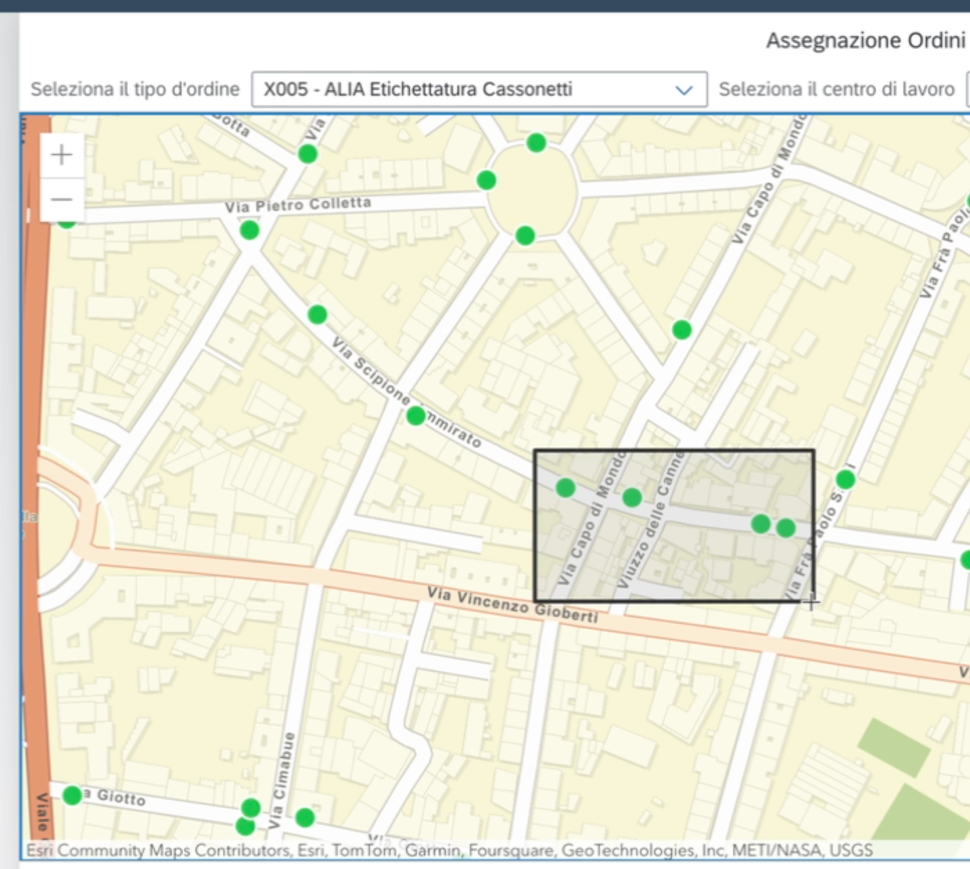

I have 9 points here on the same street with a shorter selection:
But as soon as I extend the selection on the right, without including other points, the number of the points returned is greater:
Very strange behaviour. I hope that someone can help me on this.
