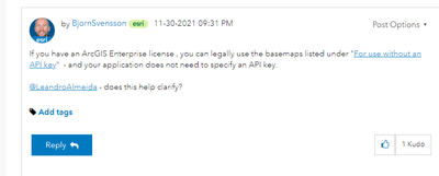

If you have an ArcGIS Enterprise license , you can legally use the basemaps listed under "For use without an API key"  - and your application does not need to specify an API key.
@LeandroAlmeida - does this help clarify?
