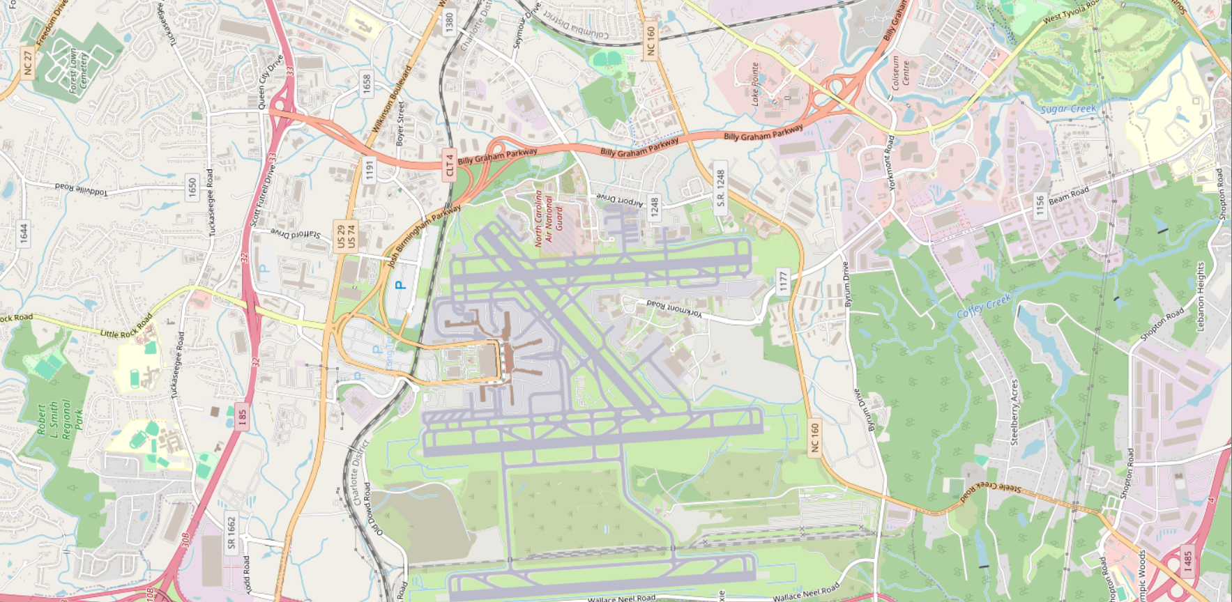

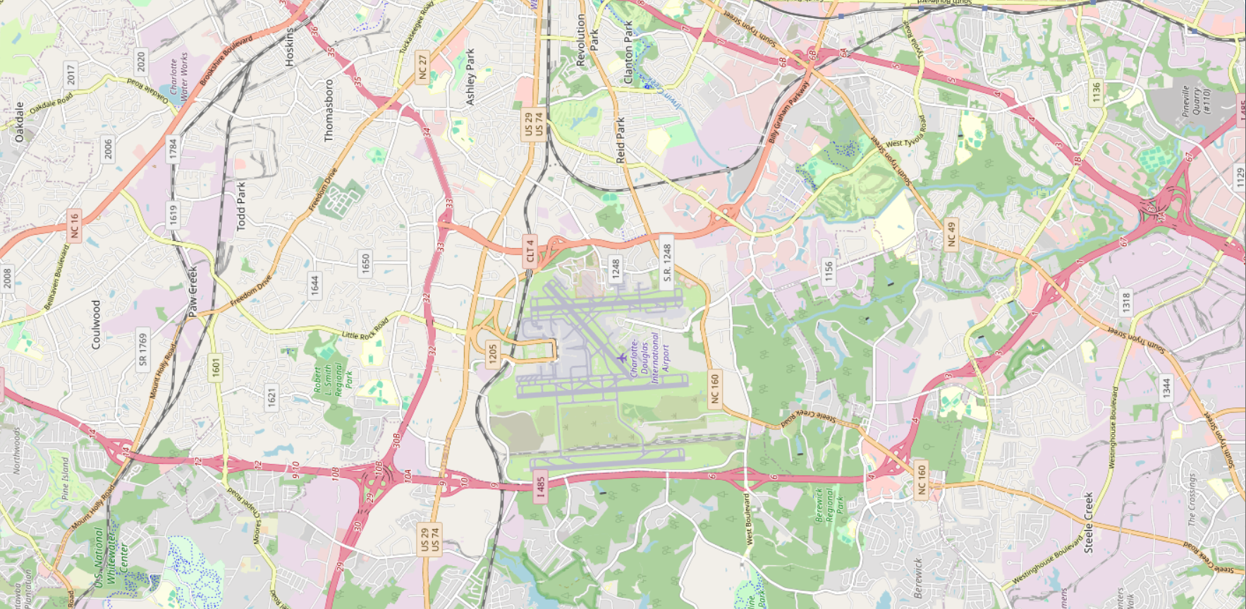

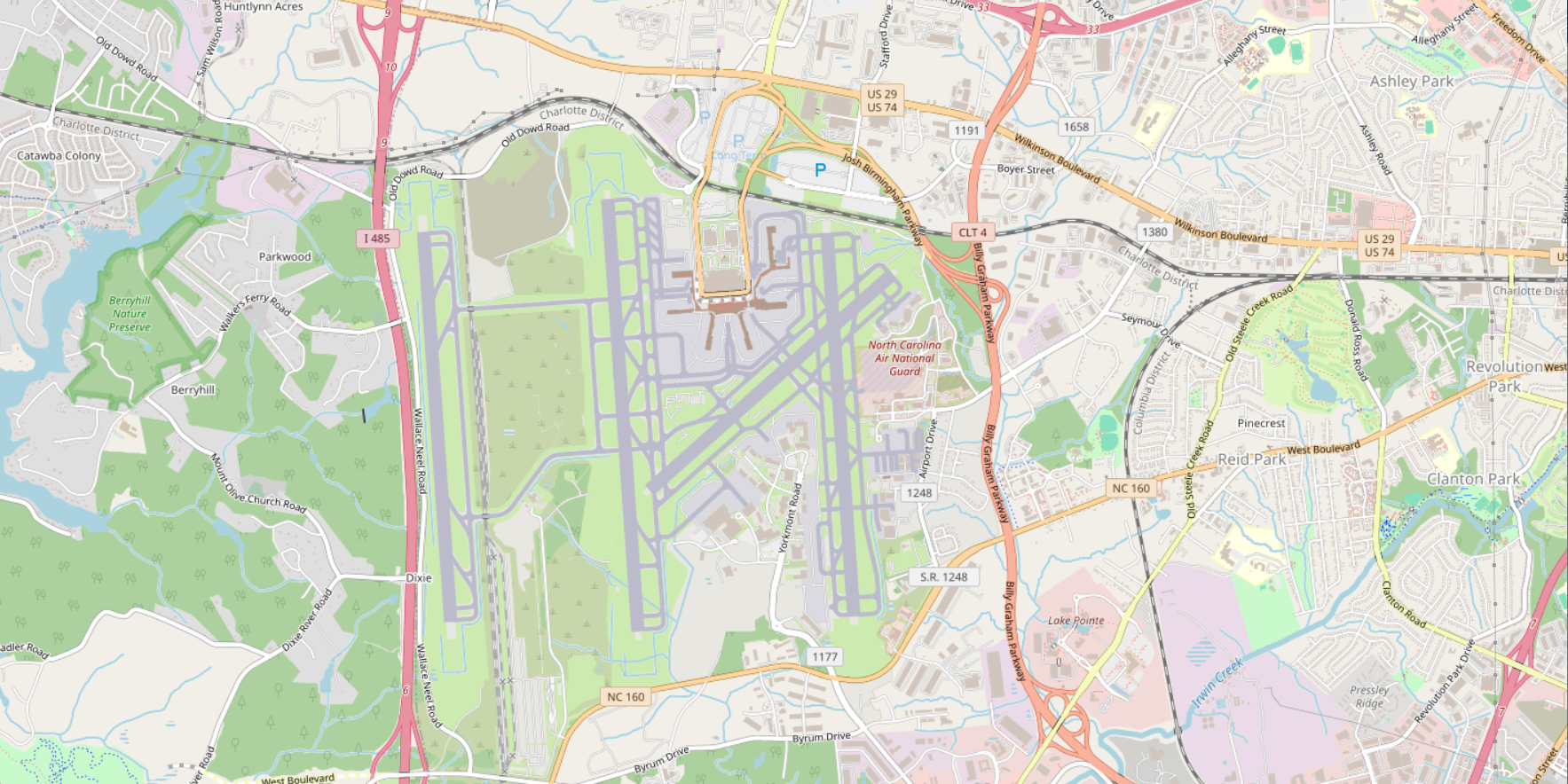

When doing this in 4.28 and prior, the map scale was preserved, but not the extent.  Starting in 4.29, the extent is preserved, but not the scale.  In order to visualize this, see the images below.  The first one is the starting state, where rotation is zero (i.e. North is "up"):
Now, let's say the user wants to rotate the map 90 degrees counter-clockwise so that East is "up".  (In the code, we'd set the rotation value to 270.)  Here's what it looks like in 4.28:
We see the scale has stayed the same, which is the expected behavior.  However, here's what it looks like in 4.29:
We see that the map has zoomed out one level in this case.  Were my browser maximized at the time, it would've zoomed out two levels instead.  If the user were to repeat this process, the map would continue to zoom out each time.
