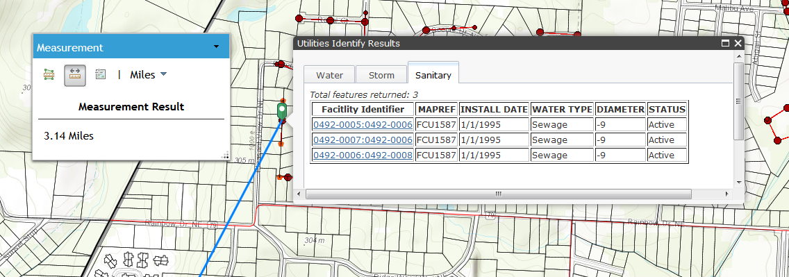

I would like to deactivate the identify when doing measurement.

This makes the identify window showing up each time I click on the map. I would like to only call the identify only when I click on the identify button on the toolbar to activate the identify function. But when I try to call the initFunctionality() from a button click event, the identify won't work. for some reason, it is only working when called from map.on("load") or map.on("layers-add-result").

RichardMoussopo
Thank you Tim for replying,
but it does not seem to work. I am wondering if it could be the mouse-over method. is there a measure-start method?

RichardMoussopo
Added, and the identify is still showing up when measuring and yes, I am using 3.10 version:
