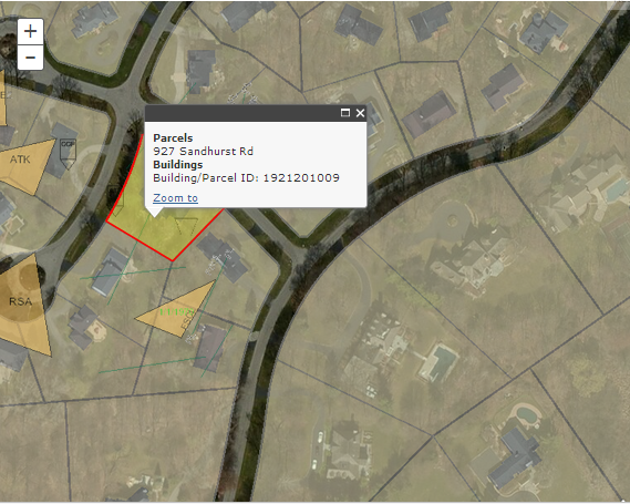

I try to identify a parcel and return results on the same infowindow but missing a "Zoom to" link and can't figure out how to highlight a parcel only.
I put the code here:
Edit fiddle - JSFiddle
Hope someone can show me what I am missing...
Thanks.

   You will not get the zoom to or feature highlight without setting the infoWindows.setFeatures method. More like this sample: Display identify results in popup | ArcGIS API for JavaScript

if I set the infoWindows like this -
map.infoWindow.setFeatures(results);
Nothing shows up anymore. Can you show me on the JSFiddle?  Thanks.

This gets you closer, but it also returns the layers you haven't supplied content for.

Thanks for your sample.  Eventhough I define the layerName I want, but it still shows up all layers.  Can you show me how to exclusive some layer names?
Thanks.

   Here is a fiddle that only does the parcels (i think the way you want).
JSFiddle Link

Actually I try to identify multiple map services with certain layer names with their attributes to show up in ONE page infoWindow and then only highlight parcel polygon.
I only find out I can use content to do it but won't highlight any result at all based on the Robert mentioned above - NEED map.infoWindow.setFeatures(results).  I used the sample you all shows on JSFiddle, I can't show all attributes information in one page.  What do I need to modify it so can show all results in one page?
Thank you for your time.

If below is the result you are looking for combined info result with zoom to.
Below is your modified showIdentifyResults (inserted lines 17, 24, 47)

MayJeff
Deactivated User
Thank you very much.  This is what I need.
