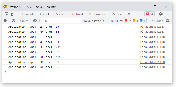

Using ArcGIS JavaScript API 4.24 and uniqueValues from esri/smartMapping/statistics/uniqueValues I am able to get Count of all features in a FeatureLayer (fcLayer in this code)
In this example respond is based on AppType field from fcLayer
            uniqueValues({
                layer: fcLayer,
                field: "AppType",
            }).then(function(response) {
                let infos = response.uniqueValueInfos;
                infos.forEach(function(info) {
                    console.log("Application Type: ", info.value, " are: ", info.count);
Now Can you please let me know how I can robust this code in a way that I can group and query two fields AppType and AppStat  instead of field: "AppType" only?
I tried to use sqlExpression and sqlWhere instead of field option like
sqlExpression = "AppType = 'RD' AND AppStat = 'active'"
sqlWhere = "AppType = 'RD' AND AppStat = 'active'"
in the code like
        uniqueValues({
            layer: fcLayer,
or
        uniqueValues({
            layer: fcLayer,
            sqlWhere= "AppType = 'RD' AND AppStat = 'active'"
But none of them returning any thing!
KristianEkenes
Getting statistics for two fields like this is not supported at the moment in this function. However, we are adding support for it in our next release.
In the meantime, you can use Query.outStatistics to get the count of features with values from two fields.
