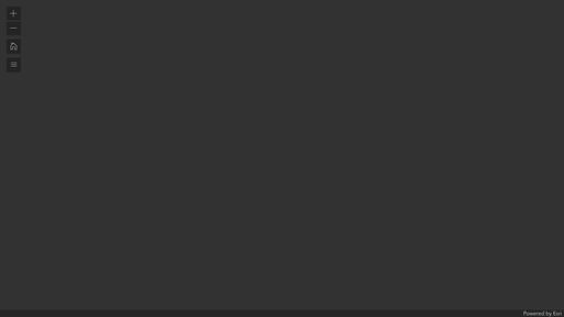

There is no such interface setting if you want to make the clustered graphics use the same symbol. It is difficult to implement this requirement as the cluster_count field cannot be used for arcade expressions and layers with a UniqueValueRenderer may not contain multiple fields when cluster is enabled. I have tested this and can only use two layers, one showing the graphics before cluster and one showing the graphics after cluster. demo: https://codepen.io/xiej/pen/LYexXNY?editors=0010
