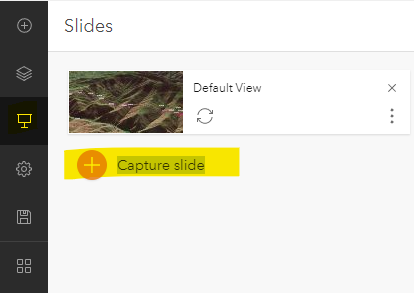

I also note that the ArcGIS Online SceneViewer includes Presentations, which allows you to persist Slides, but you have to Save the WebScene.
