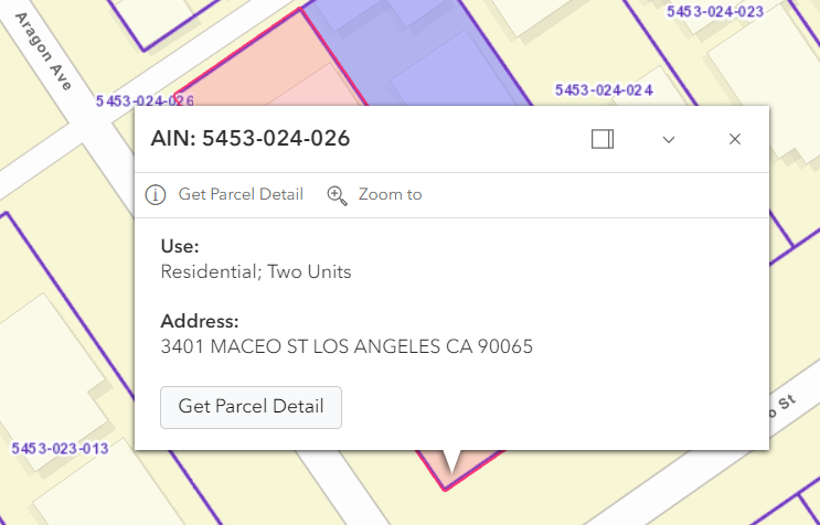

I have a Layer containing land parcels that are drawn with purple lines. Ideally, a single click right on a parcel (regardless if the mouse clicks on a spot right on or near the purple border) should activate a Popup that shows only that parcel:
However, clicking right on a point (or clicking right next to a purple line) where multiple parcels touch will fetch multiple parcels.

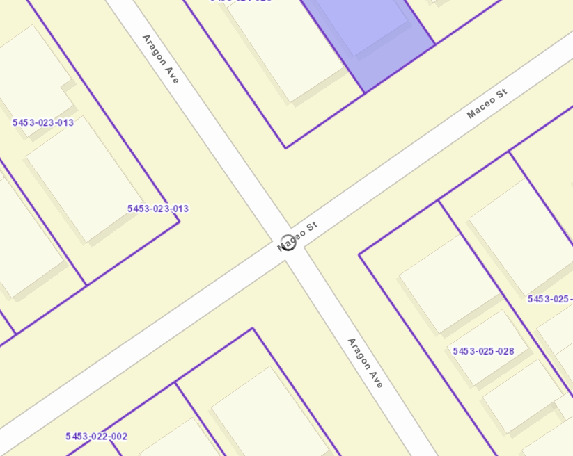

No Popup appears when clicking right on the point where Aragon Ave and Maceo St intersect:

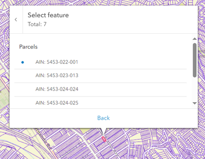

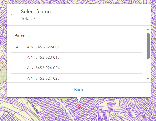

However, when I zoom out as far as possible and click on the exact same spot, four parcels are yielded (the four parcels at the four corners of the intersection):
So it seems that what's going on is this: the area of effect of a mouse click is not a single pixel point on the screen, but rather a small circle, and the size of that circle is fixed regardless of how close or far the MapView is zoomed (basically the map's scale doesn't seem to matter; the circular area of effect is the same physical size on the screen). Whichever parcel(s) are touched by that circular area of effect will be accounted for in the Popup. What I would like to do is have the Popup consider only one of the potentially multiple parcels that are gathered. The one parcel I want taken into account is the one closest to the mouse click point.
