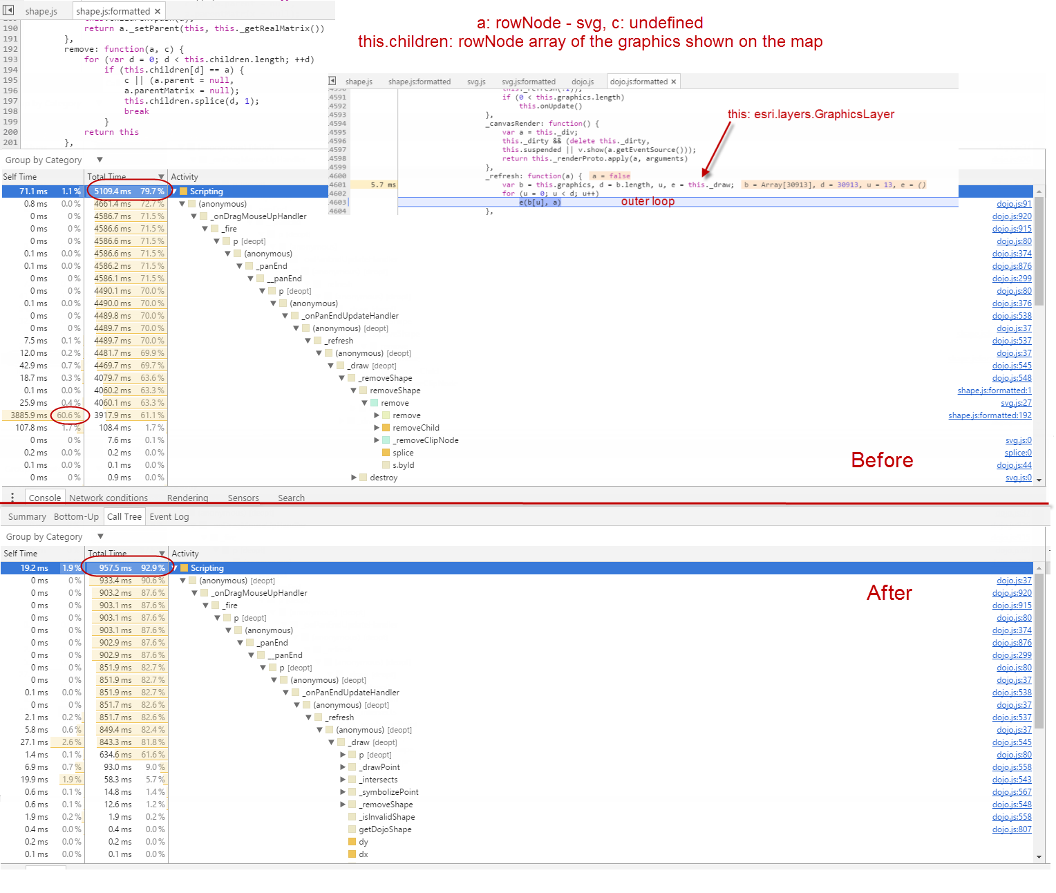

LeoDeng
Thank you for your advice.
LeoDeng
At last, I choose to override the dojo.shape.Container.remove function.
shape.Container.remove = function(a, c)
{// override the remove
    return this;
It seems better now on map pan operator.  But I don't sure that this will influence others or not.
