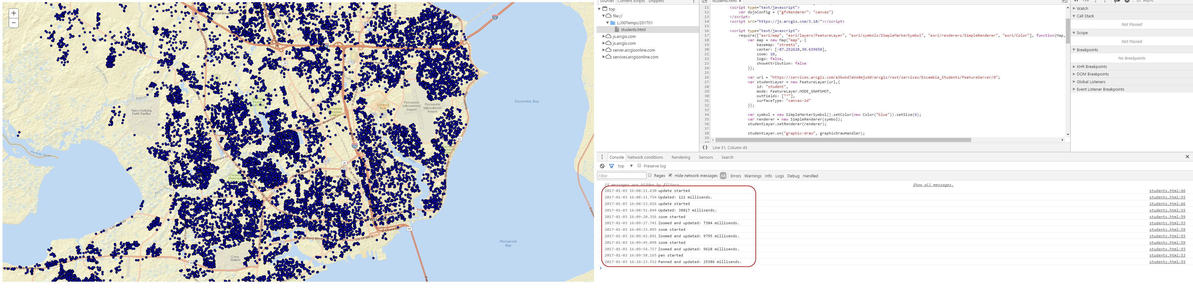

I try to calculate the time and enable cache for basemap.  I notice that the results of the graphic is drawn by <svg>.  Then I remove the excess svg attributes.
The result shows that it takes about 6-7 seconds on average for each zoom operator.

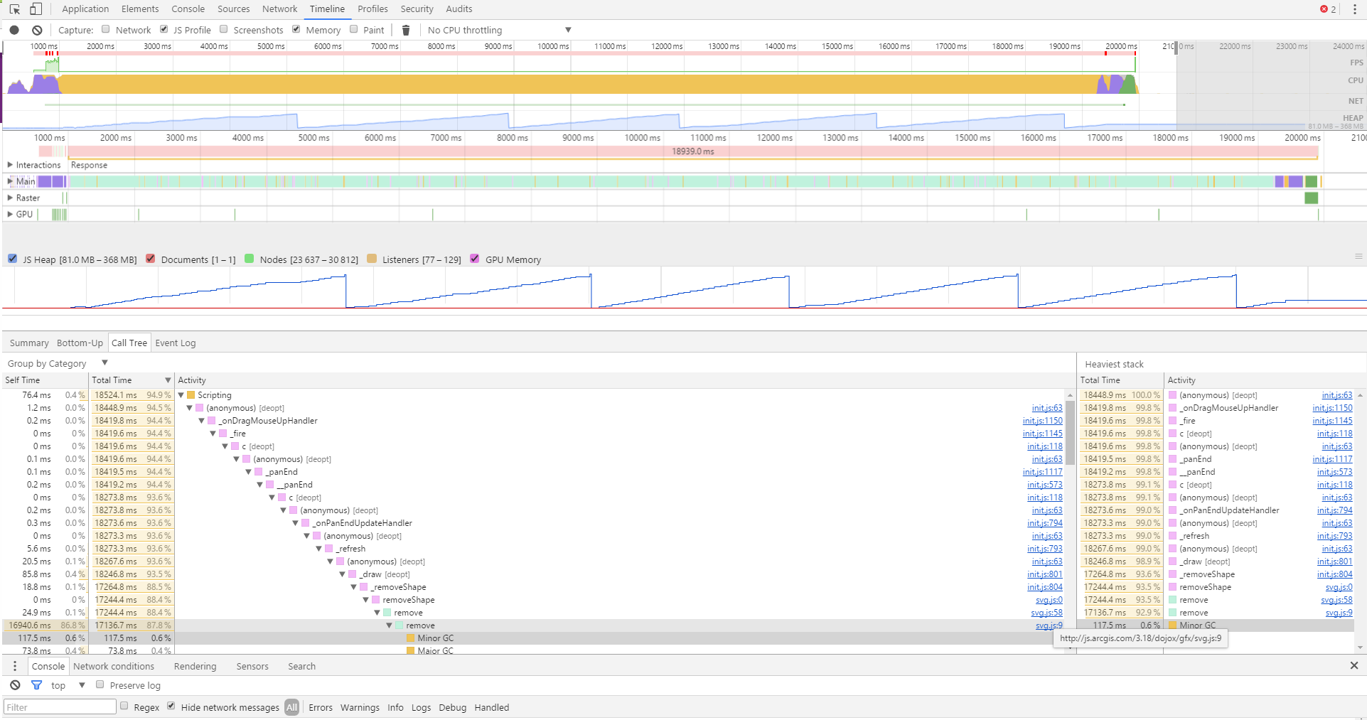

I've tried canvas instead of svg.  But the result seems slower than svg.
  • enable chrome cache for basemap

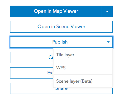

One thing you can do is publish it as a tile layer on ArcGIS Online. This will improve the performance and give you all the same FeatureLayer capabilities.

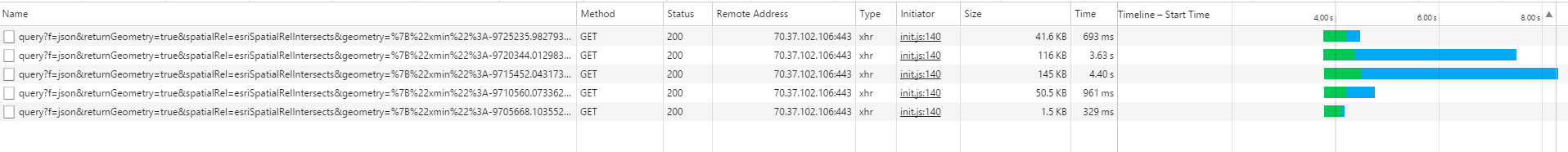

    Next, the MODE_ONDEMAND option is not my expectation.  As the result shows, it will send lots of requests each time, that is not what we want.
    Besides, under the MODE_ONDEMAND, the graphics showing piece by piece, not very comfortalbe.
