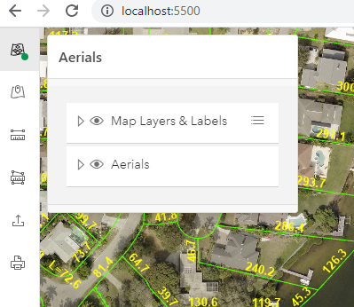

GregoryBologna
I don't have a layerList container because I'm building the layerList with listItemCreatedFunction.
let layerList = new LayerList({
	view: view,
	listItemCreatedFunction: function listItemCreatedFunction(event) {
		var item = event.item;
 yields
In html
  <calcite-action-bar slot="action-bar">
	<calcite-action data-action-id="aerials" text="aerials"></calcite-action>
  </calcite-action-bar>
  <calcite-panel heading="aerials" height-scale="l" data-panel-id="aerials">
	<div id="aerials-container"></div>
  </calcite-panel>
I'm stuck getting the layerList added to the div.
let ac = document.getElementById('aerials-container');
//ac.appendChild(layerList);

I first applied what you showed me to the print widget and a few other widgets and it all worked great, but I was still having trouble with the layerList.
      let print = new Print({
        view: view,
        printServiceUrl: printServiceUrl,
        container: 'print-block'
It was not until your next reply that I realized the issue was due to the layerList loading before the container I put it in was available (I create the calcite-blocks in code behind when an action bar item is clicked. I moved the layerList to the click event of the action bar item where it then loads and works great. Thank you!
