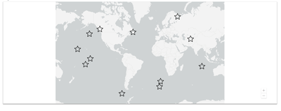

Hi all I hope you all doing well, I have a problem regarding of sizes of map, in the first load the size is good and correct and when the data is load the size of the map is changes, please check the image below
first load
after the data finish the load

Looking at the two images, you can see star pins in areas of the map that aren't visible on the first map. When you run the following code snippet, you are telling the map to resize.
const zoom = CalculateZoomLevel(mapDiv, locations);
mapDiv.current.center = [centerLocation.longitude, centerLocation.latitude];
mapDiv.current.zoom = [zoom];
Without seeing everything in CalculateZoomLevel, it's hard to identify specifics, but I suspect the method is getting the extent of all the features and using that in part of the calculation.
