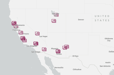

Hello,
I want to know How can I change the pin location image in map? I want to give my custom image as shown in image
12 Replies
NEERAJNASWA
The code is now working, But I need help in removing the blue highlight color after clicking the pin image.I am sharing my code.

JillianStanford
I'm not sure of the answer but you could try setting the highlight option property on the Map View
https://developers.arcgis.com/javascript/latest/api-reference/esri-views-MapView.html#highlightOptio...
NEERAJNASWA
Thanks, the Highlight option worked as per the expectation.
