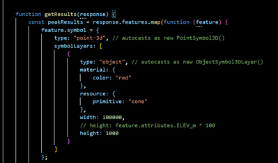

I haven't tested it out but you could try something like
//create the marker
var marker = {
type: "picture-marker",
url: "https://arcgis.github.io/arcgis-samples-javascript/sample-data/cat3.png",
width: 46,
height: 46
//apply it to each graphic
const peakResults = response.features.map(function(feature) {
feature.symbol = marker;
NEERAJNASWA
