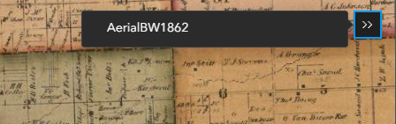

I thought I would be able to change the layer name from AerialBW1862 by using a label property in the Layer List component, but it has no effect. I've tried most other relevant-sounding properties, but still no effect. Here is a sample

The layer name comes from the "layer.title", so you can add your own title when you create the layer.
SteveCole
Honored Contributor
Was just coming to post that. Example mod to your code:
      const image1862 = new ImageryLayer({
        url: "https://gis.willcountyillinois.com/image/rest/services/Orthoimagery/AerialBW1862/ImageServer",
        title: "Aerial Photo",
        maxScale: 3000,
