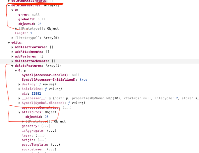

You would listen to the edits event of the Layer you are interested in. The Editor itself will not give you this information.

In the event that comes on 'edits', there is array of features were deleted. But int's object there is only one attribute returned 'objectId'. Screenshot 2024-04-02 at 12.40.08.png
Is there any way to configure the layer to get at list global id in this event or maybe all of the attributes?
