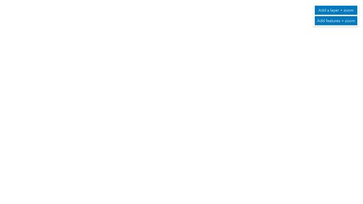

If the features are added when the client-side layer is created then you can just zoom to the fullExtent of the layer. If you add or remove features from your client-side FeatureLayer then you can call queryExtent method with `1=1` where clause.
This app shows both approaches: https://codepen.io/U_B_U/pen/mdBQQRY?editors=1000
