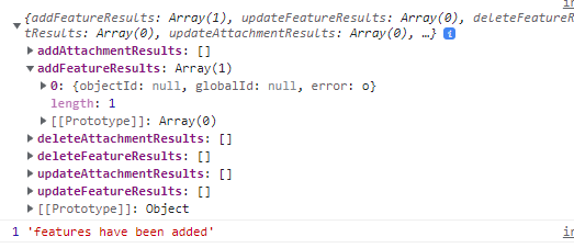

I am adding doing a console.log of the features added to the addFeatures method, and it shows like this.
The feature after shows as
 But when the same featureLayer is added to the map afterward, it gives the errors
