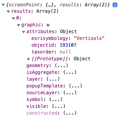

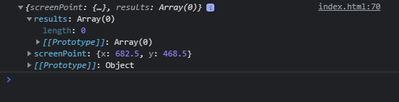

I got it to work but I'm still not sure about how to grab the value from the 'esri symbology' field. I've console.log'd the hitTestResult, but in the console it says its returning an empty array under 'results' along with a screenPoint (x,y) and a bunch of prototypes. How do you think I can grab the attribute data I need?

Unfortunately I'm still getting an empty array, but I'm guessing its based on my location? Nevertheless, thanks for all this help. I'm pretty new to this.
WAIT so the first time i click it, I always get 0, then the second time (and after) I click it, I get an array of 2. How can this be?

I set an override for the Location sensor in my devtools
This is inside one of the features in your service.

With the empty array issue. I ended up changing the event to an immediate-click event which will work better in my case and allows me to by pass that sensor issue.
