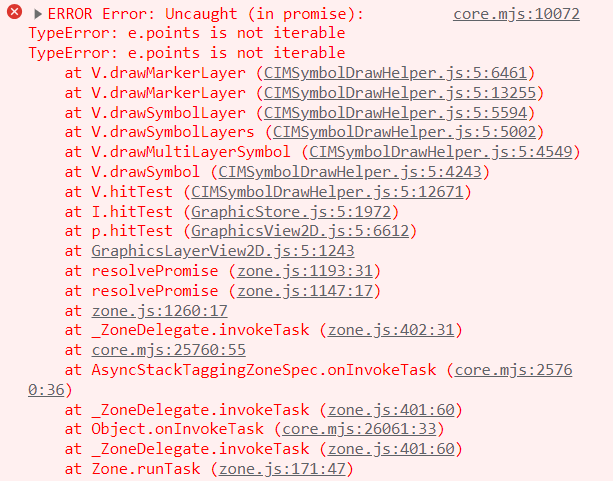

I have an error while clicking the map view if it contains line graphics.
I tried to exclude all graphics layers, not needed in my scenario, but I get the same error.
I use ArcGIS Maps SDK for JavaScript 4.26.1

Maybe it's fixed in the current version: 4.27
MohammedZaki
No, it is not working either.
Plus there is one more bug in this version with the update button in editor widget. see this
ReneRubalcava
Esri Frequent Contributor
Could you post a github repo or stackblitz showing this issue? Looks like it's related to zonejs and Angular, so need more context.
