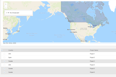

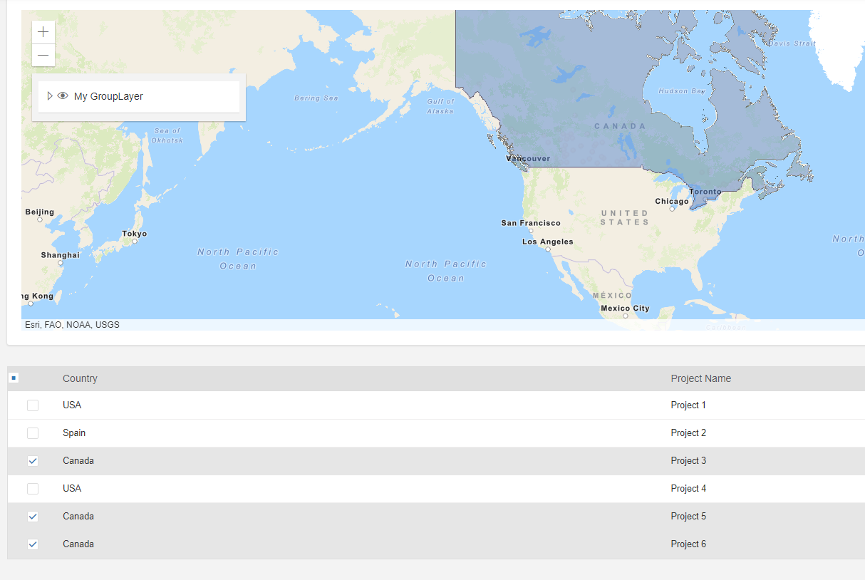

Good day,
I have these two requirements:
  1. Tapping a country (or multiple countries) on a map highlights the country and selects rows for that country on a data grid.
  2. Tapping on the data grid selects the row and highlights the country (of the selected row) on the map.
I'm able to achieve requirement #1 with the codes specified in - https://developers.arcgis.com/javascript/latest/sample-code/effect-blur-shadow/
But for #2, I can't seem to find an api that will accept country name of country fid nor any post about this.
The code in the link uses:
var query = {
   geometry: view.toMap(event),
   returnGeometry: true,
   outFields: ["*"]
featureLayer.queryFeatures(query);
But on the next requirement, the input country will be from the selected row and not a coordinate from the map.
Anyone know if there's another API for this or if this is possible?
Here's my test page -
Thanks!

I was able to resolve the requirement above though using Query object. Here's a sample code:
queryObject = new Query();
queryObject.where = "COUNTRY = '" + selectedCountry + "'";
queryObject.returnGeometry = true;
queryObject.outFields = ["*"];
query.executeQueryJSON(queryUrl, queryObject).then(function (results) {
	if (results.features) {
		graphicsLayer.graphics.add(results.features[0]);
Thanks!
