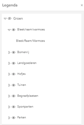

I have a layerList with legend that works beautifully for normal layers and groups. But I'd like it to show tileLayers as normal layers instead of groups.
Currently it does this (only "Groen" is a group, the rest are tileLayers):

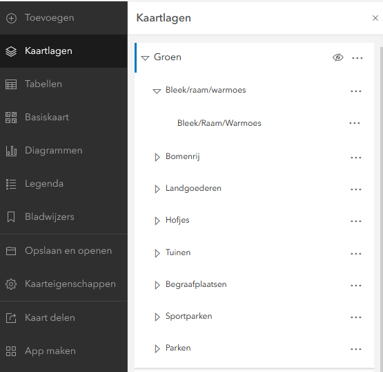

It looks the same if I open the map in the esri map viewer:
Is there any way for me to change this so that the tileLayers do not have the arrow to open them? Or should I just not work with tileLayers?
Any help would be much appreciated!

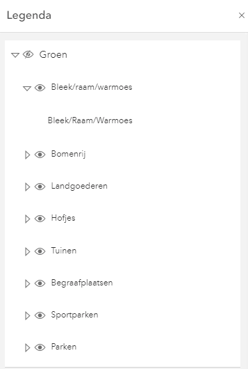

That works like an absolute charm, thank you very much!
LeidavanHees
I case anyone needs this in the future. It works even better when using allLayers instead of layers:
const webmaps = webmapids.map((webmapid) => {
    const webmap = new WebMap({
        portalItem: {
    // wait for the webmap to load
    webmap.when(() => {
        webmap.allLayers.forEach( (layer) => {
            if (layer.type === "tile") {
                layer.listMode = "hide-children"
    return webmap;
Since that also fixes it for any tileLayers inside of groupLayers
