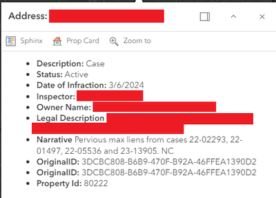

I appreciate your help. Below is a picture of inspecting the results in chrome and showing that when a field that is in the data but not in the popup is referenced in the feature action, it comes back as 'undefined'.
And the style tag isn't working.

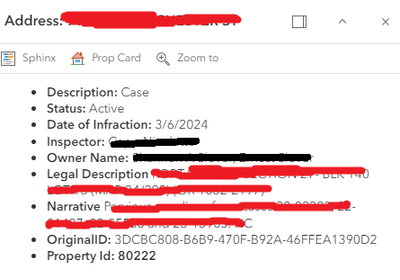

This code gave the below result.

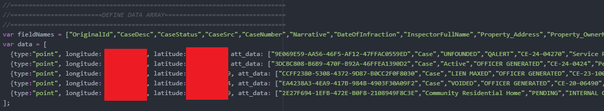

The data is coming from an array out of an API and turned into graphics and then the graphics are turned into a feature layer.
Perhaps that has something to do with the necessity of the attribute being in the popup to be accessed in the feature action function.

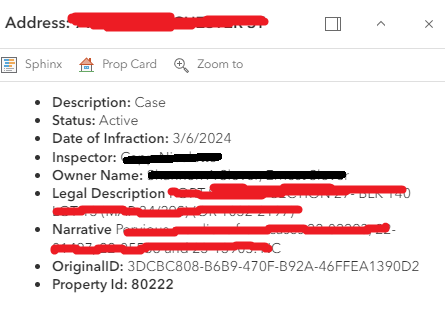

Needed to add the outFields parameter set to return all fields.
    const template = {
    	"title": "Address: {Property_Address}",
    	"content": [{
    		type: "text",
        outFields: ["*"],
    		text: "<ul><li><b>Description:</b> {CaseDesc}<br></li>"+
              "<li><b>Status:</b> {CaseStatus}<br></li>"+
              "<li><b>Date of Infraction:</b> {DateOfInfraction}<br></li>"+
              "<li><b>Inspector:</b> {InspectorFullName}<br></li>"+
              "<li><b>Owner Name:</b> {Property_OwnerName}<br></li>"+
              "<li><b>Legal Description</b> {Property_LegalDescription}<br></li>"+
              "<li><b>Narrative</b> {Narrative}<br></li></ul>"
      actions: [openSphinxAction,openPaAction]
