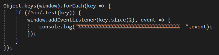

Also triyed to see all events to find the right one, with no success.
