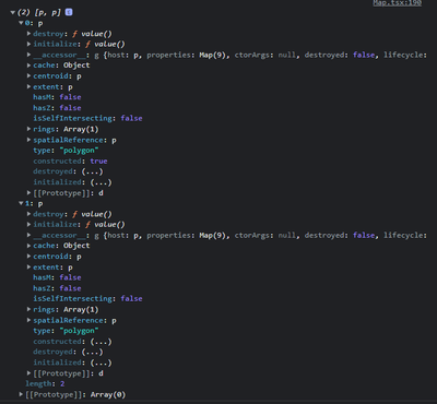

Hey,
Im trying to do the goto function for serval geometry but it seems it zooming only to the last geometry in the array,
not really sure why and how to handle it
that's the Array of Geometry im passing, in not getting any errors

eyalj
view.goTo(geometryArr);
GeometryArry is the array in the first pictrue
And that's the view
 notice that it works it just zooming to one of the geometry in the array instead of all of them

Can you provide a codepen showing the issue?
https://codepen.io/
No way to tell without seeing it in action. It could be a bad geometry, spatial reference mismatch, or something else.
