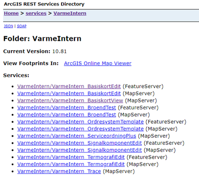

diaconori
this.layerStructure.traversal((layerNode) => {
                        let layerServiceUrl = layerNode?._layerInfo?.layerObject?.url;
                        let featureLayer = new FeatureLayer(layerServiceUrl);
// your suggestion
I have implemented your suggestion on line 4, but it throws an error saying that load, then and when doesn't exist. I checked the docs, and they aren't listed there: https://developers.arcgis.com/javascript/3/jsapi/featurelayer-amd.html
Access to the layers of the map through LayerStructure: https://developers.arcgis.com/web-appbuilder/api-reference/layerstructure.htm
"jimu/LayerStructure",
You can paste the code in your postCreate method, after importing the above in your AMD.  Your web map needs to import an ArcGIS REST Service of the type: MapServer, as rest services of the type FeatureServer can provide _fields through a proxy object:
Not sure if it is different on a plain webpage that you're calling the ArcGIS JavaScript API from, but it seems to be vastly different when you're running WAB on ArcGIS Enterprise.

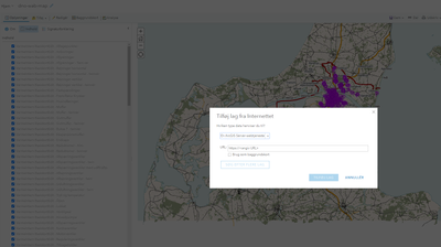

Where to import on your web map:
