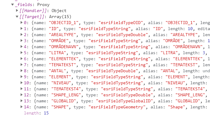

I have implemented a widget tool for our ArcGIS Enterprise solution, similar to the SelectLayerByAttribute tool from ArcGIS Pro, however, I am having trouble trying to get the information regarding the fields. The provided information in the documentation and the forums are not up to date, as all suggested answers do not work, despite any service url that is being provided.
I can see, that the information is there, but hidden by a proxy object. If the web map is using a FeatureServer REST service, we are able to fetch the '_fields' and deconstruct the proxy object, but if the web map is using a MapServer REST service, we are not able to even call the property and store it in a variable. Any solutions to this?

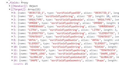

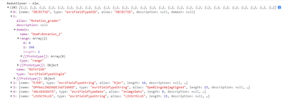

You're a legend! You made it work regardless of them being either FeatureServer REST Services or MapServer REST Services. Thank you so much.
Result of FeatureServer REST Services using JohnGrayson's answer:
Result of MapServer REST Services using JohnGrayson's answer:
May I please ask what and why should we 'wait' for a layer to be loaded. Aren't they supposed to be loaded upon instantiation of the FeatureLayer object through it's constructor? I mean, I can see that the _fields property exist as a proxy object, but I can't fetch it without using your approach with the load-function. This is the code that works now with the accepted answer:
