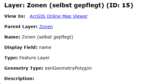

This is how a layer looks on the service:
Why is it empty in JS after loading the webMap?
