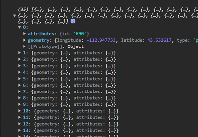

Here is sample of the featuresArray.
Rohit_Venkat_GandhiMendadhala3

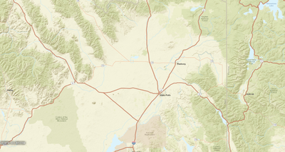

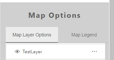

No errors, code runs fine but layer doesnt display (points dont show up). The title displays in the map options, but points do not show up. Unfortunately, this is part of a big code base, cant upload the codebase
JoelBennett
MVP Regular Contributor
It was good to convert the lat and long to numbers as Rene suggested, but I see in your screenshot the "id" values are still strings.  I've seen features not render in cases of duplicate or invalid objectid values, so you should probably convert those to integers as well, whether via Number or parseInt.

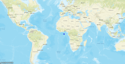

Ok, I have just changed the id to a diff field and it loads just one point, that too with a mismatch of spatial reference. Any recommendations on this?
JoelBennett
Is it really just one point, or a load of points stacked on one another?  If it is just one point, I would recommend autogenerating the objectID values as in a previous response.
As for the wrong location, it looks like it's treating your long/lat values as Web Mercator x/y values.  You may have to project the coordinates into Web Mercator, which is easily done with webMercatorUtils.lngLatToXY and then use "x" and "y" properties instead of "latitude" and "longitude".
