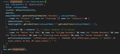

I’m using the ArcGIS Maps SDK for JavaScript (v4.33) within a React application, where I dynamically create layers with custom renderers and label configurations. I recently upgraded my application from v4.30 (where everything functioned correctly) to v4.33.
The issue:
  • Layers that have no labelingInfo on the server work fine.
  • But whenever a layer has labelingInfo defined on the server side, my app crashes with the following error:
Question:
  • Is this a known issue with labelingInfo + renderers in v4.33?
  • Am I missing a required property in the labelingInfo definition?
  • Is there a way to tell the API to ignore server-side labelingInfo (or safely override it with an empty labelingInfo  : []) when creating a FeatureLayer?

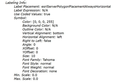

Service URLhttps://abc.com/server/rest/services/abc/AdminBoundaries/FeatureServer/1
Labeling Info:
I’ve attached a screenshot showing how labeling info is being passed.
I noticed that in layers where the labeling info is empty under Drawing Info, there is no issue. However, when labeling info is present (as shown in the screenshot), the website crashes (as shared in my original post).

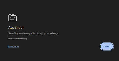

My application works fine when I set labelingInfo: []. However, as soon as I add any configuration inside labelingInfo to enable labels, the app crashes with the error “Aw, Snap! Out of Memory.”
I followed the official Esri labeling article and implemented the steps exactly as described, but even that code results in the same crash.
This issue only started appearing after I upgraded from v4.30 to v4.33, where the same configuration worked without any problems.
