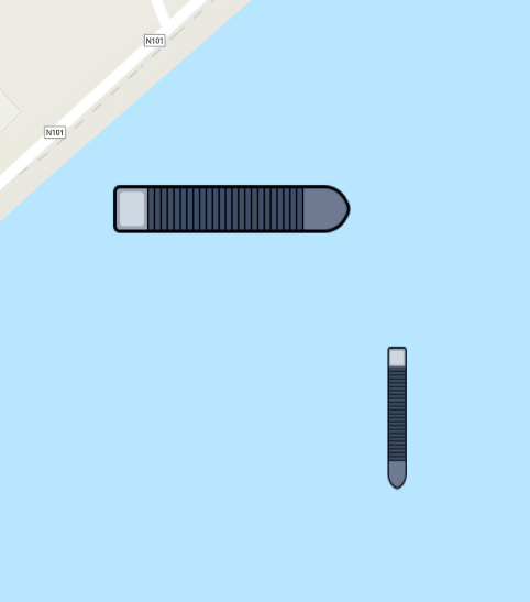

Hi! My labels are not visible for my featureLayer (labelingInfo) with CIM renderers.
Made a codepen to reproduce this issue! Thanks in advance.
https://codepen.io/michaelk95/pen/YPKoOQq
You can reproduce the issue by switching the renderer from rendererSimple to rendererComplex. when using CIM renderer " rendererComplex " no labels will be visible, when switching to the simple one: "rendererSimple", labels will be present.

Hi @michaelpoa - thanks for bringing this to our attention! This appears to be a bug with labels and real world size visual variables. You'll notice if you remove the size VV from your "rendererComplex" - the labels will display as expected. We'll look into it.
