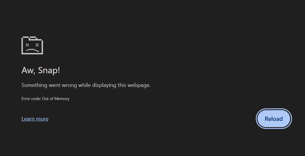

I’m using the ArcGIS Maps SDK for JavaScript (v4.33) within a React application, where I dynamically create layers with custom renderers and label configurations. I recently upgraded my application from v4.30 (where everything functioned correctly) to v4.33.
The issue:
  • Layers that have no labelingInfo on the server work fine.
  • But whenever a layer has labelingInfo defined on the server side, my app crashes with the following error:
Question:
  • Is this a known issue with labelingInfo + renderers in v4.33?
  • Am I missing a required property in the labelingInfo definition?
  • Is there a way to tell the API to ignore server-side labelingInfo (or safely override it with an empty labelingInfo  : []) when creating a FeatureLayer?

My application works fine when I set labelingInfo: []. However, as soon as I add any configuration inside labelingInfo to enable labels, the app crashes with the error “Aw, Snap! Out of Memory.”
I followed the official Esri labeling article and implemented the steps exactly as described, but even that code results in the same crash.
This issue only started appearing after I upgraded from v4.30 to v4.33, where the same configuration worked without any problems.
