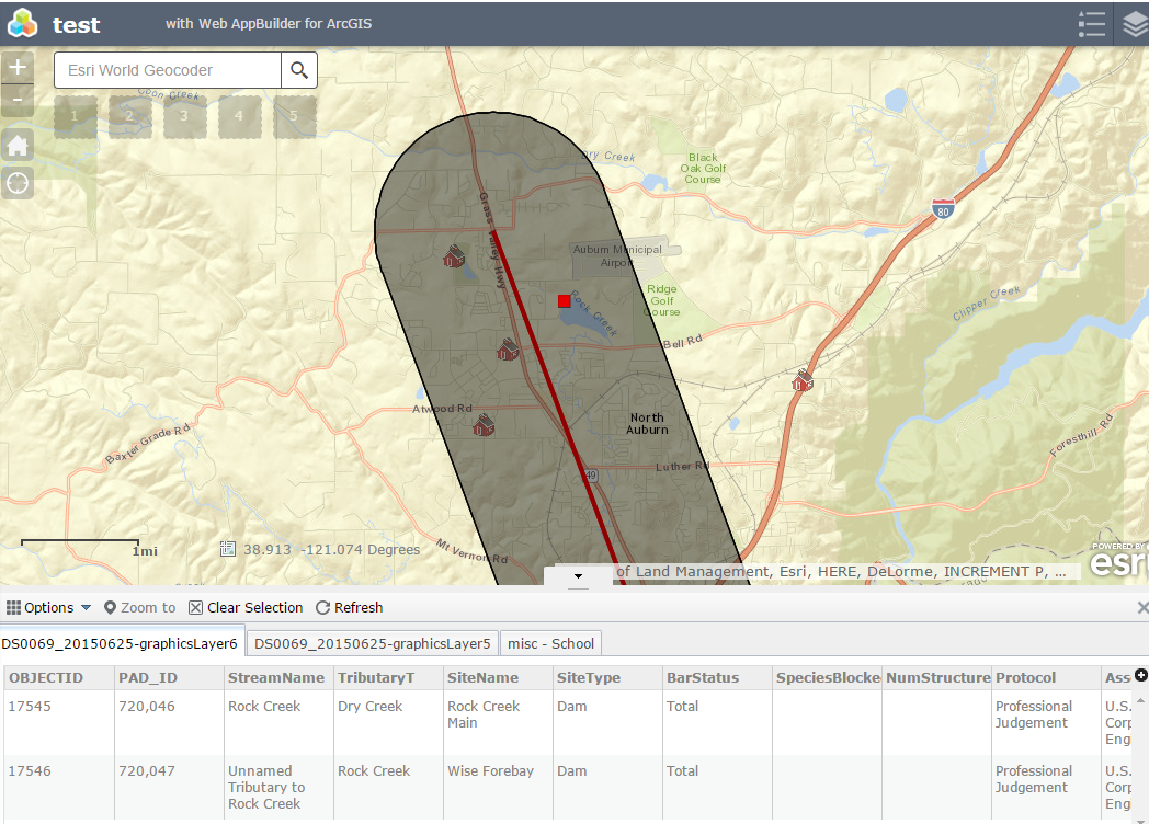

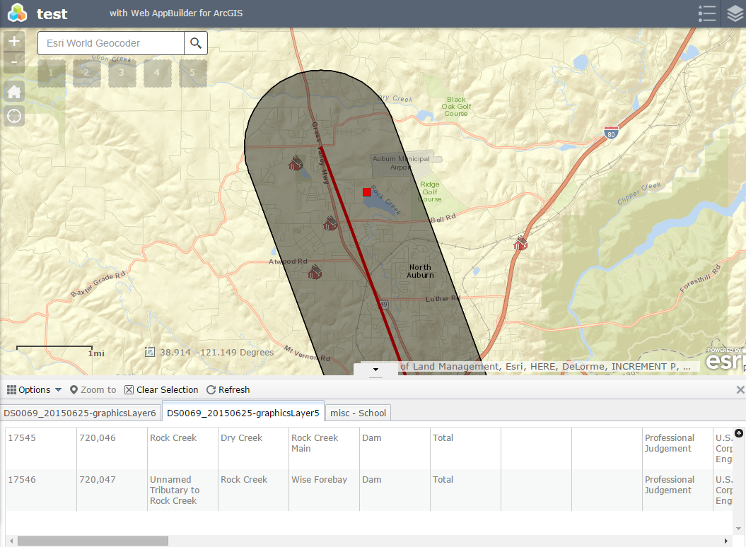

yes, i agree. Thank you for you kind words and your time. I have an observation. The selectInBuffer is called twice, creating two tabs on the Attribute table, one is with the field names and one one without it.

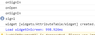

I just copied the code you gave me and I got this. This is bizarre. One of the screenshot (see below), shows the first tab with the field names and the second tab without the field names.  So, I placed in the "theselectInBuffer"  a console.log and it was called twice, and hence calling the attribute table twice.
selectInBuffer: function (results) {
        array.map(results, lang.hitch(this, function(feature){
          this.thelayer.add(feature);
  console.log("sign1");
        this._openResultInAttributeTable(this.thelayer);
output:
