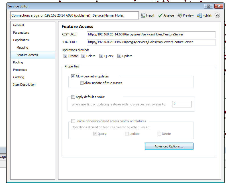

   When you setup the feature access for the map service did you make sure that the capabilities on Feature Access, included Operations allowed: Create, Delete, Update?
RaymondGoins
holesFS.jpgYes.
