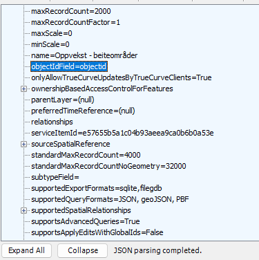

(my layer's objectIdField is called objectid (all lower case)).

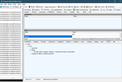

I can see that the function makes the POST but ignores the [toDelete] parameter that was passed in. What am I doing wrong?
JoelBennett
MVP Regular Contributor
In order for the applyEdits operation to successfully process the deletes, the objectIdField must be set.  Although I suppose you could manually set it, this ordinarily doesn't take place until the layer has loaded.  Therefore, I would recommend something like the following change:
