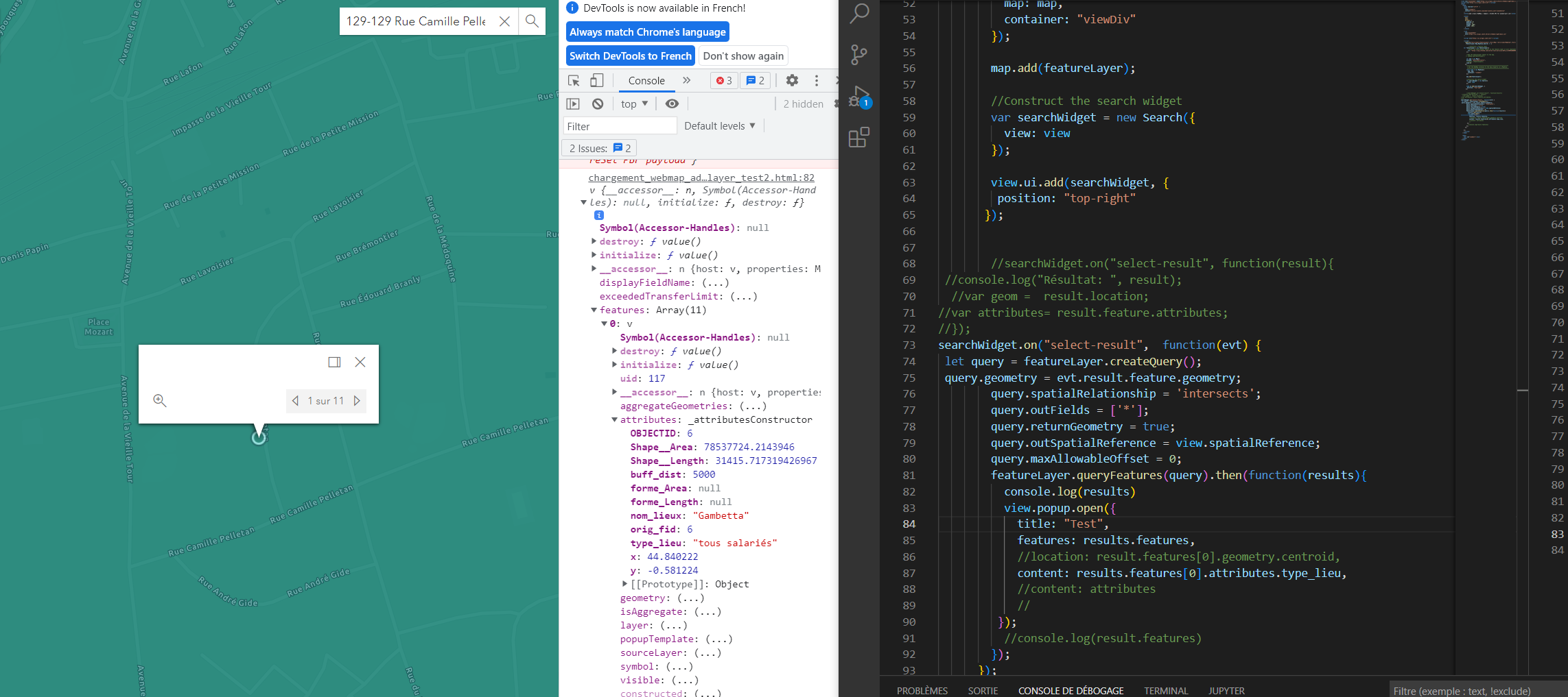

Hello everybody, i'm newbie on JS for arcgis. I'm trying to query by the search default widget, intersecting the result to a feature layer and get few attributes in the pop up.
I think I see the goal but nothing appears on my pop up. I got results but even the title doesn't appear!
Is there something wrong on my code? Do I have to use a poptemplate?
I need some help.
Thank you very much

The documentation for view.open indicates that when the "features" property is set, it will use their popupTemplates to render the content of the popup.  Therefore, I believe this is why your title and content are ignored.
I think the solution would go something like this:
featureLayer.queryFeatures(query).then(function(results) {
	results.features.forEach(function(graphic) {
		graphic.popupTemplate = {title:"Test",content:"{type_lieu}"};
	view.popup.open({
		features: results.features,
		location: evt.result.feature.geometry.centroid

Yes it works!! Thank you @JoelBennett !
