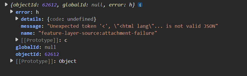

I have a popup trigger "Add Attachment". It invokes a function to dynamically create a form and select an attachment.
It returns an error :
The function addAttachment

let layer = feature.layer;
layer.addAttachment(feature, attachmentForm).then((result) => { console.log("attachment added. If successful it will return the objectID of the feature ", result);
  } }).catch((error) => {
console.log("attachment adding failed: ", error);
 document.getElementById("fileSelector").click();
Any help is appreciated

Hi Noah,
I tried different attachments and the same error happens. The mapping is part of a bigger application.  Originally, it was .net framework MVC and the code was working fine. Recently, we upgraded to .net core 8 and the same code fails.
Noah-Sager
Looks like the attachment may be invalid? I would try several different attachment and/or attachment types.
MKY
Hi Noah,
