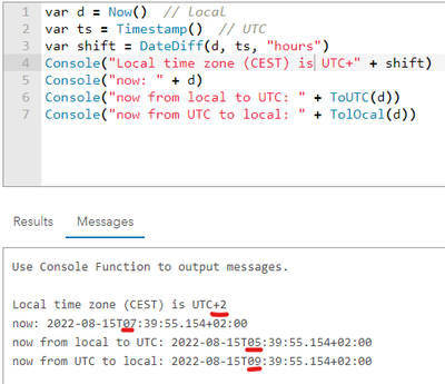

@JohannesLindner how do you manage the time offset due to timezones, epoch ignores timezones
JohannesLindner
MVP Alum
Again, no idea how to do it in the JS API.
Arcade has the functions ToUTC() and ToLocal(), which convert your local date to UTC or vice versa.
Have a great day!
Johannes
