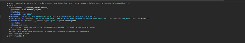

Thanks, I Hosted my shapefile as a hosted layer.  now i am getting another error. Which is 403, unauthorized. I am just adding a layer. although i am owner of that particular layer and i am using owner API key as well. But i am not able to find out what is happening.

vickylsdev
Here are error and code:

Sage_Wall
Is the API key from a stand alone developers account or from an ArcGIS Online account.  Secured services can only be accessed with an API key from the stand alone pay as you go developers account.  If the api key is from a developers account there is a ui in the configuration of the API key to allow access to specific portal items and services.  With an ArcGIS Online or Enterprise account you need to set up the authentication in another way.  The different authentication types are described here: https://developers.arcgis.com/javascript/latest/secure-resources/
